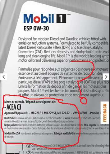

I've seen people using this on this forum before, and there are youtube videos of people using it (and also using the advanced fuel economy variant as well). This is the first oil that comes up everytime I type in ENGINE OIL for my car in a search result on any automotive site. This is also the oil that the dealership used where I bought my car prior to my purchase. I've used it for two of my oil changes so far (about 10,000 miles worth of driving). Now, I haven't experienced any issues, but I want to make sure that this is the proper oil and is okay to be using with the 2.0L Q4 Giulia.
I know some people are just gonna say "buy from the dealership" or "go order the OEM stuff online", well that's easy for you to say but the closest dealership to me is 2 hours away and they won't ship the stuff, and I'm not driving 2 hours to pickup engine oil.. I'm also not ordering engine oil from Europe and waiting a month or two for it to get here and paying import shipping costs..
The problem with this oil is the back of the container is not very specific, but on the mobil 1 website, it looks like it meets specifications based on what they have documented for it.
Anymore insight into this? Can I use it or not?

Based off the website information, the oil "should" meet the SP requirements. However, to be safe just use 0W-30 oil with the actual SP donut certification label on the bottle like the Mobil 1 Advance Fuel Economy version.
The Mobil 1 ESP oil is formulated to be more of a diesel engine oil and may contain more calcium(bad for our engine) than the AFE oil.

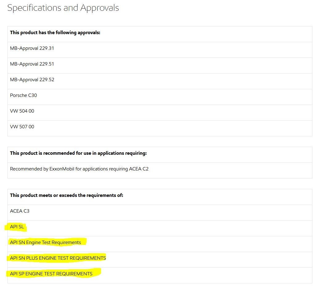

Just to add to the confusion, the European site is more updated...and mentions LSPI.
While it doesn't have API's donut...some of it's other approvals do have LSPI tests in them.
It's a really good oil...However, if something did happen, I wouldn't be surprised if Alfa denied a warranty claim simply because it doesn't have the API donut.

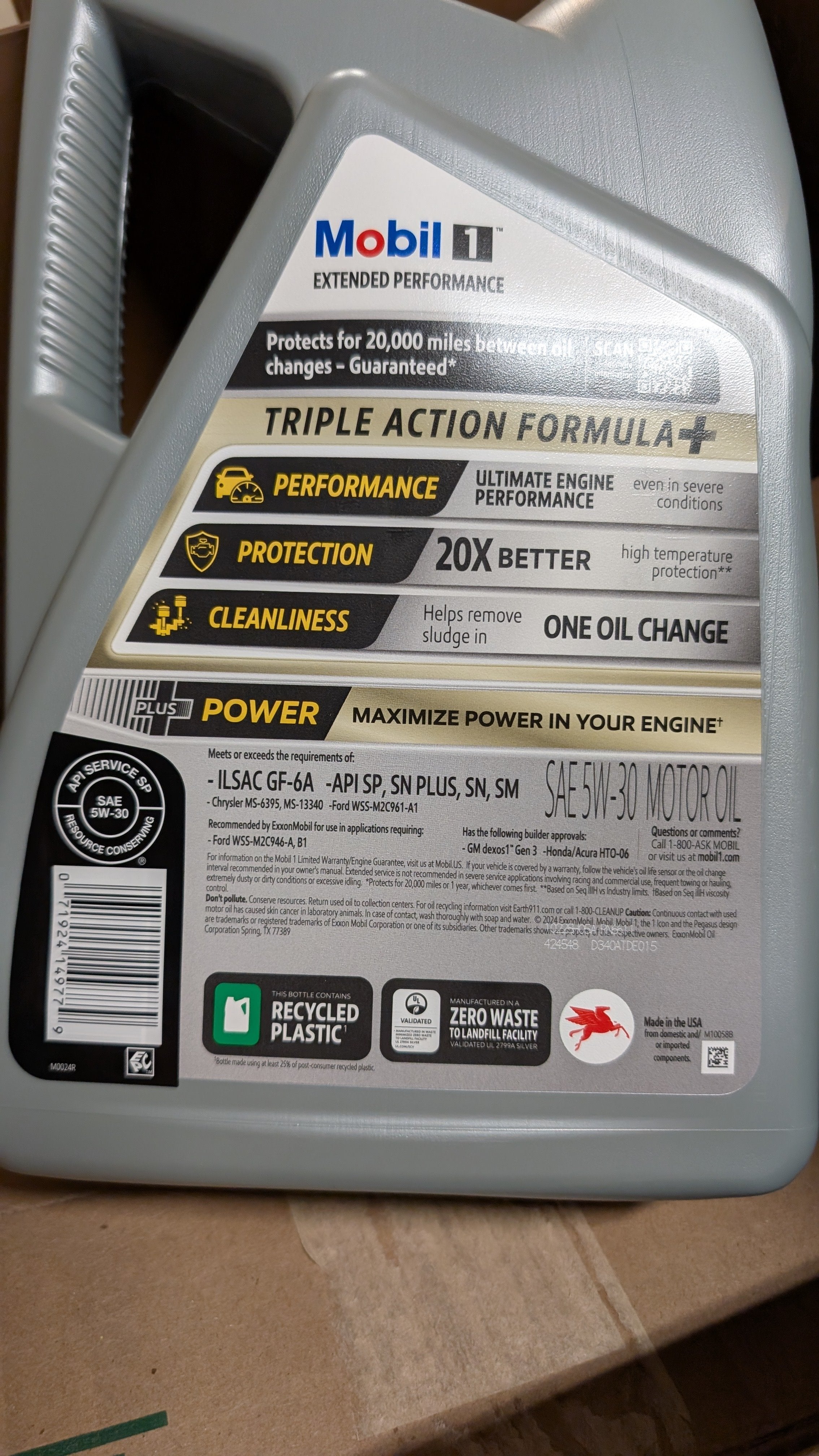

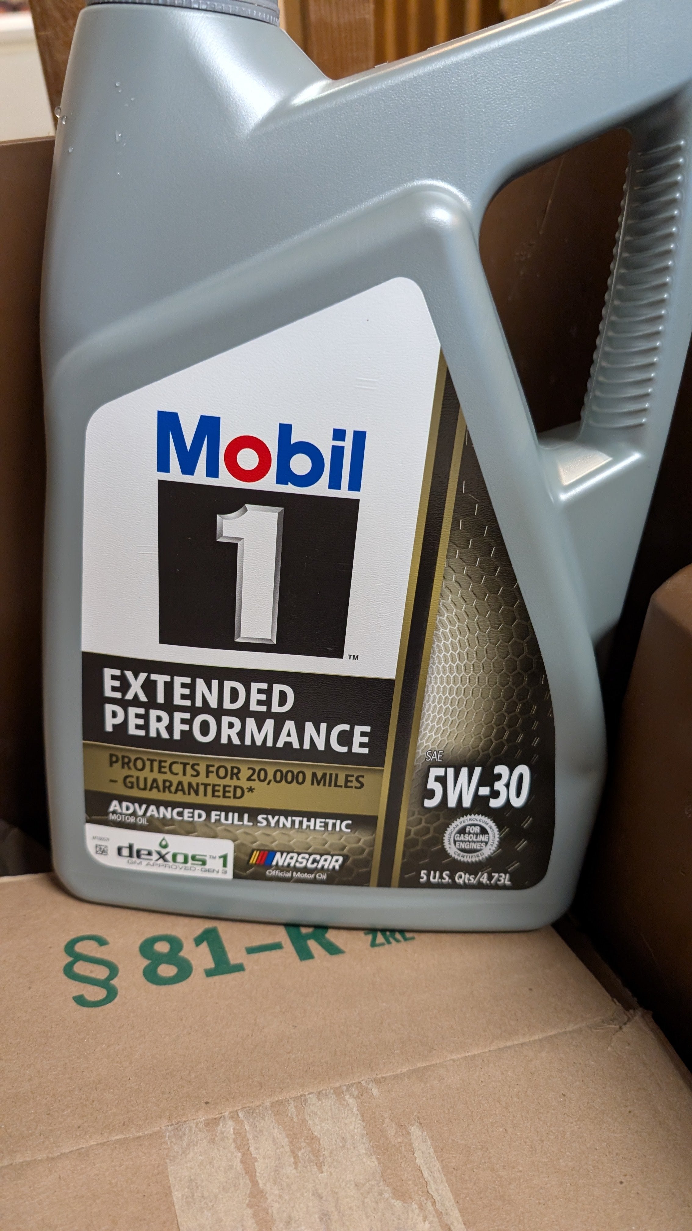

I just filled with this on Monday.
Yeah, I know... 5W-30. wah wah I don't care
