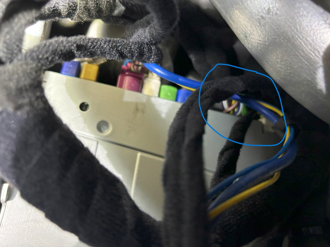

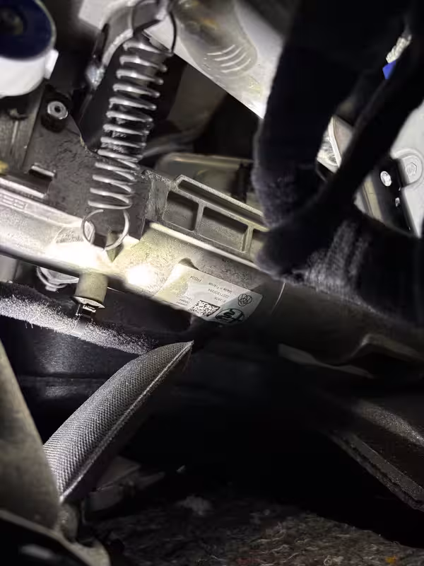

Need help please - trying to find the SGW. RHD MY22 Quad. I have removed the sunglasses compartment ( 1 torx screw and trim tool) but i cant seem to see the SGW. Please see photos. Help appreciated. There's a metal box mounted vertically which seens to have some coloured connectors on top but they look small and up very high. The connectors on the far right are inaccessible because of the silver metal bracing strut.
#94 · (Edited)
Just did a search for RHD SGW and found two threads that confirm that the SGW is to the left of the steering column on a RHD vehicle.
This post says explicitly that it is to the left of the steering column:
This thread has a video posted by the same person that show his SGW on the left side of his steering column, not the right.
If you view that video on YouTube, read the comments. Someone asks if it is to the left of the column and he confirms that it is indeed to the left of the column on a RHD vehicle.
So on LHD car, SGW is right of the steering column. But on a RHD car, the SGW is to the left of the column.
#95 · (Edited)
Eureka!! You, Sir, are a gentleman! It seems to be on the LEFT side. Up high. Can't be seen from below unless cables are pulled to the side (and i had to cut a cable tie that was in the way). I can feel the little plastic tab to push in but cant get them out (index finger a bit sore). Will try some leverage etc later.
Again, thank-you!
