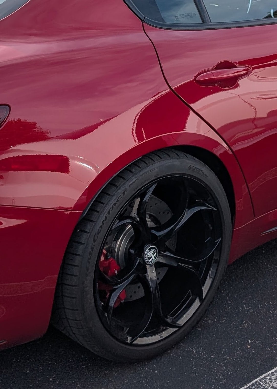

With most cars, its the front wheels which get the majority of the brake dust. .For some reason, my QV accumulates brake dust a lot quicker on the rears.. Stock brake pads.. Anybody else experience this?

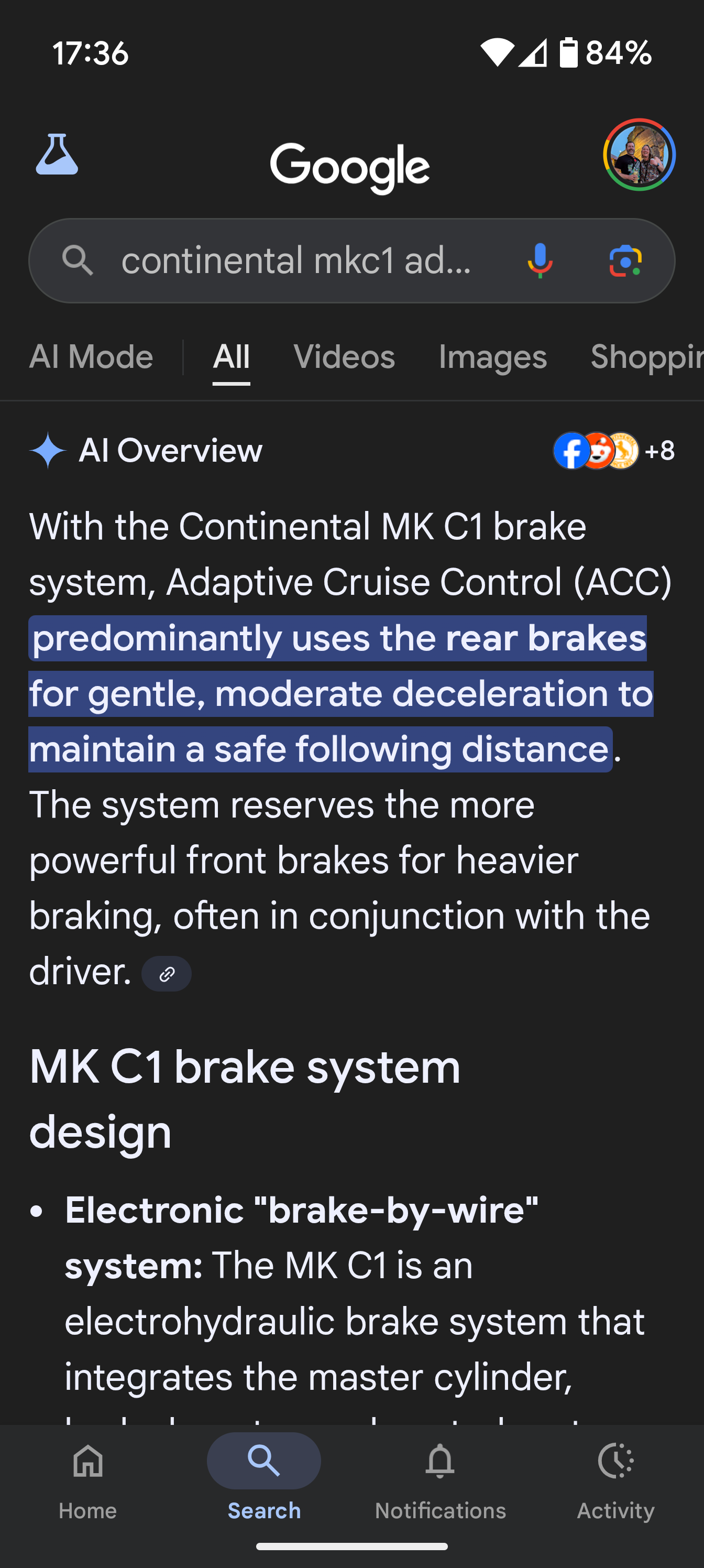

#11 ·
Yes it does. Adaptive cruise uses the rear brakes to regulate speed.
owns 2018 Alfa Romeo Giulia Ti Sport Q4
Reactions: Emozine
#12 ·
I'm not about to dig into the technical docs for the answer as ultimately it's moot but I think the rear EPBs handle some of that, at least on QV. My car with service EPB light won't engage ACC due to said light.
