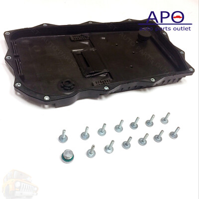

52854834AB: Chrysler/Dodge/Jeep/Ram 845RE plastic pan with integrated filter, full kit with gasket. These are made in USA pans so prices in north america are a lot lower than the German-made pans, and there are some cost-savings on the design, the biggest one being there's no drain plug on the bottom of the pan. Frankly with the location of the fill plug this is a non-issue, a basic suction gun will get the few quarts above the pan level out in a minute.
68225344AA, 68261170AA: Chrysler/Dodge/Jeep/Ram 8HP70/8HP75 plastic pan with integrated filter, full kit with gasket. I'm assuming these are Euro-made, they cost a pretty penny here. They look identical to the pan that came on my 8HP50, including drain plug.
There is no functional difference between any of these options other than the visual differences and obviously metal vs plastic. While the 8HP75 is a bit beefier inside, the 8HP45 (845RE), 8HP50 (850RE), and 8HP75 pans are identical according to ZF's service information. You're welcome to try other car brand's 8HP45-75 pans, they're probably fine.

PPE cast aluminum pan: Transmission Pan - Heavy-Duty Cast Aluminum - ZF 8-Speed
This pan looks nice but isn't cheap. Installation is finnicky, you need to transfer the metal bolt hole bushings from your OEM plastic pan to the bolt holes in the PPE pan. I've also read a review where PPE drilled the holes for the filter in the pan off-center and asked the person who got that pan to file the holes in the filter to move it over, which is completely unacceptable. You're also at the mercy of their third-party filters being in stock/the company not disappearing.
I would avoid other aftermarket pans, while there's some cheap looking pans with replaceable filters, there's a lot of reviews of them leaking. It's not worth the hassle of dealing with a leak, especially with what the OEM fluid costs.
