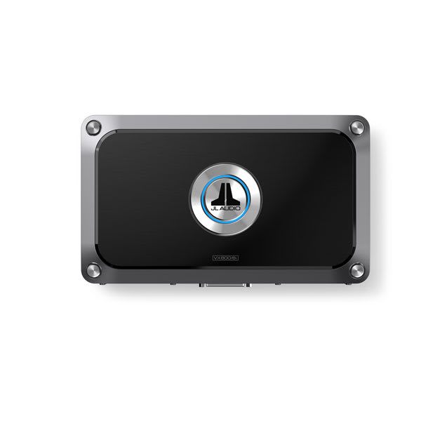

So for disclosure I went with the JL Audio HD 900/5 for my amp. JL Audio C5653 in front, JL Audio C3650 in rear, audiocontrol DM810, and JL Audio CS110TG-TW3 for sub. I disabled center speaker and stock subwoofer. Sound is definitely studio quality and very happy with sound. Negative is disconnecting stock speakers puts a yellow speaker in the dash with warning stereo not available. Car is sensing the resistance of the speakers is gone. This is a little annoying. Stereo works fine but warning is always on. Audiocontrol rep tells me putting in resistors prior to DSP will turn off warnings might try it one day when I have time to kill. Draw on car is not very substantial with this amplifier as it is very efficient 80% less than standard amps. Very little heat generated and amplifier does not strain at all even at very high volumes as I have gain turned way down on amp. My biggest concern is the car’s auto shut off I have to turn if off every time I get in because I feel the draw at lights will be very hard on battery.
