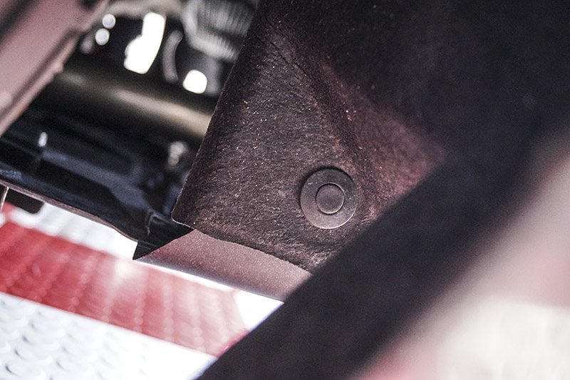

Locate (3) Push pins at Rear Wheel Liner (Located Rear Bumper Cover)
Using Small Flat-tip Screw Driver Remove Center portion of push pin and pull up.
Remove Push Pin (3)
Fold Back Liner

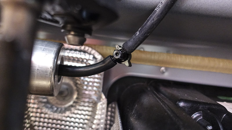

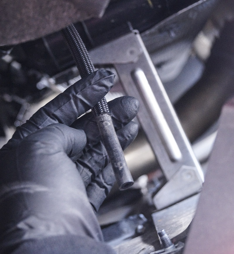

Located Silicone Line Attached to Valve Located On Exhaust
Carefully Pull Off line attached to Exhaust Valve
Vacuum Line Storage:

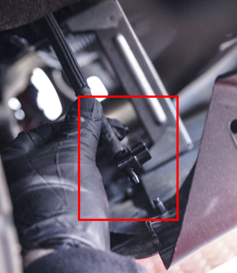

Insert 1/4 Vacuum plug OR 1/4 Vacuum Valve into Vacuum Line (Ensure Vacuum valve is in closed Position)
Zip-tie Vacuum Line or secure Vacuum Line to Nearby Bracket.
(This procedure must be completed to both sides of the Exhaust, as both sides have individual Valves)
Additional Vacuum Line Options:
**An additional step you can take is to attach a small 1/4 hose (We suggest Silicone due to the exhaust temps) to the other side of the Vacuum Valve and reconnect this to the exhaust valve. This will allow you to place the system into standard operation with a turn of a knob.**
